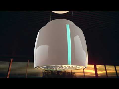

See the YouTube movie I made for some examples of what's possibe!

* Power and Light tested with Miele CVA 7845
