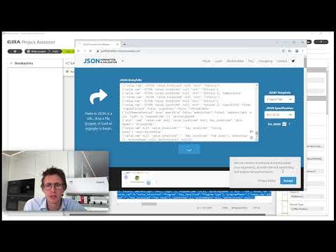

    See the following video for Step-by-Step instructions:
